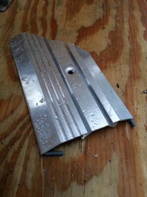

Not really an update but I spent the better part of today working on mine. I gutted it to help my brother-in-law move and figured I'd do some maintenance on it. It was covered in mold and mildew and the rear frame support was rusting out really bad from the salt.
Turns out, the rear frame was much worse than I had thought and others with enclosed trailers need to pay attention because this trailer was bought new less than 3 years ago. I had to cut out one piece of structural steel and can hopefully salvage the other piece. Not how I wanted to spend my day...

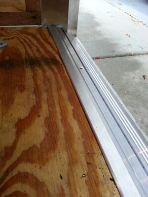

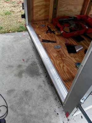

Got a reinforced steel subframe bolted in this morning and custom cut a door sill to bridge the gap and seal the area. Still not ideal but it is better than what was there and it shouldn't rust. If it keeps going the way it is, I'll have to strip the entire back end off the trailer in a couple years and replace all of it properly. Not sure if installing this aluminum sill from new would have prevented this from happening in the first place or contributed and hid it until it was catastrophic.
