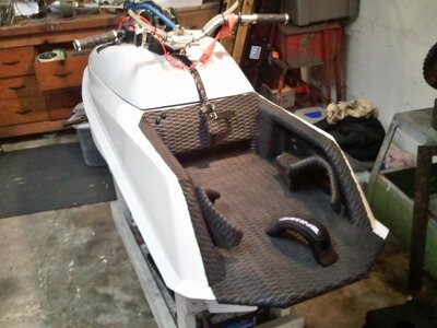

I re did the old girl with some blue tray/hold turf and some white rails. 3m foam fast 74 commercial rattle can. Works well and has not come off yet.

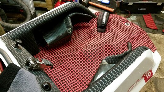

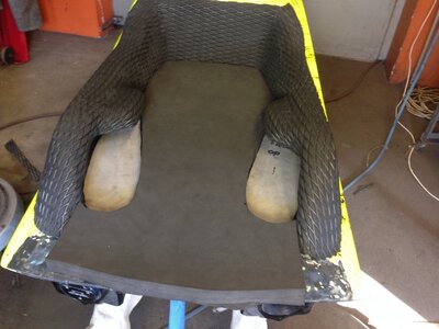

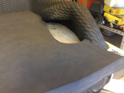

just returfed my footrocket a few weeks ago... didn't returf the footholds - so they have some wear and tear.

Kinda random, but your padding on the back end of the tray reminds me of a human silhouette.
lol - yeah, I realized that after I was done. I followed the tray contours of the footrocket... last time I did 25mm in the deep part of the tray, and 10mm everywhere else, so it was flat. This time I used 25mm throughout. super cushy this time.

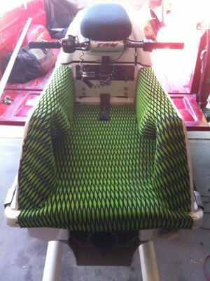

here's what it used to look like

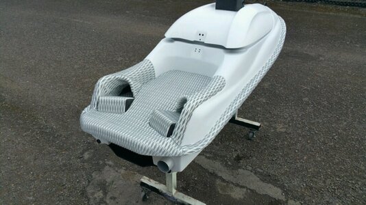

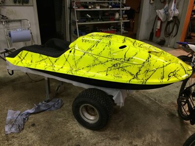

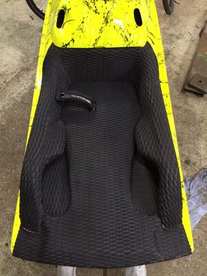

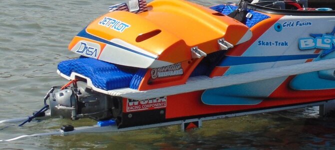

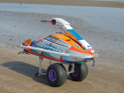

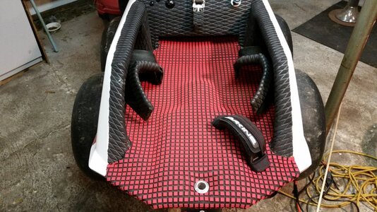

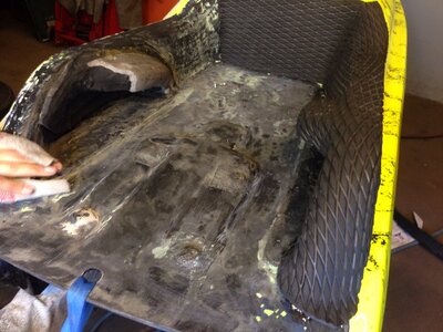

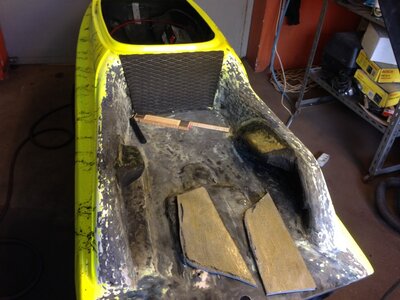

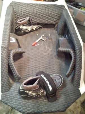

Heres a badass from Denmark getting returfed. Previously Blues old freak thats finally gotten a shine up.. And thanks to Tem for inspiration to the color scheme on the ski :)
