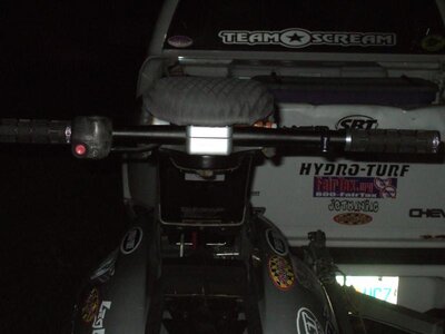

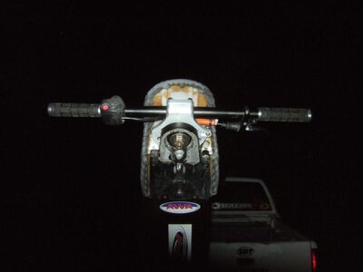

Finally installed steering and bars. An incredibly simple job! I love it already!
Pics are dark...it's dark!
