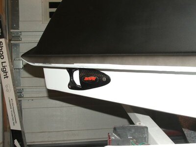

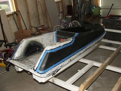

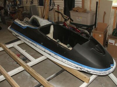

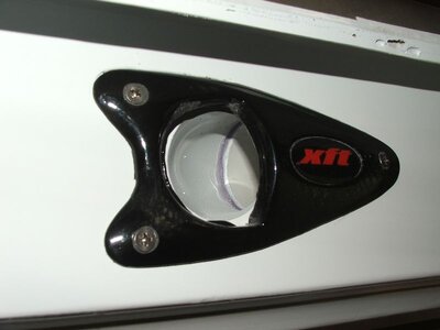

A couple shots of the nifty XFT rear side exhaust outlet.

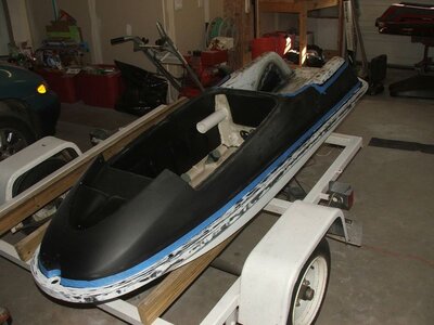

freestylegeek
waiting...
Grand Rapids, MI

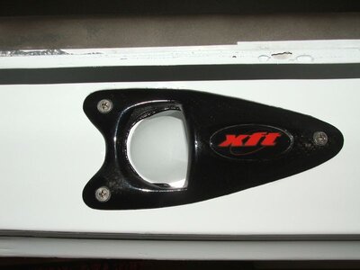

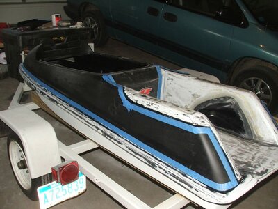

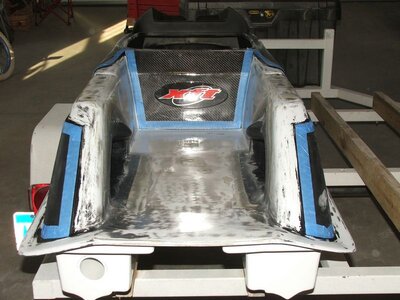

Sanded, taped, and prepped for 'turf.
I'll be turfing it later tonight at DancesWithSuperjet's house.
Can someone slow down time for me a little bit? :smile:

waterfreak
I had a vision!
Vendor Account
s florida
I know your running out of time but I would throw a little bi-axial mat re-inforcements on that tray area between both footholds...it sure can't hurt and also gives you a piece of mind when jumping those huge waves in Daytona!
freestylegeek
waiting...
Grand Rapids, MI
And add more weight!?!?!? :cool2:
I see your point Steve, but the pump cavity supports most of the tray right there, and I got complete contact on the whole area when I bonded the top. I also made sure I had foam support directly under the sole part of the footholds. Sergio also runs about 6 layers of unidirectional varying 45º on each layer.
If it cracks in Daytona, I'll tell everyone that Steve told me it would. :smile:
