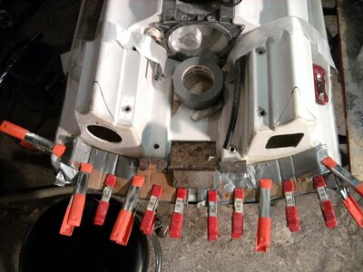

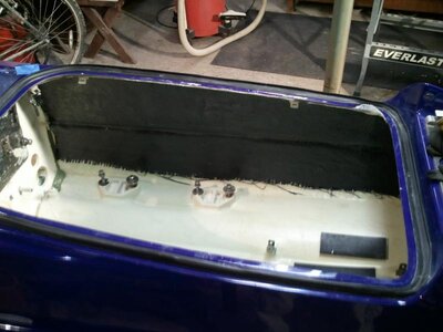

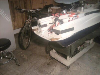

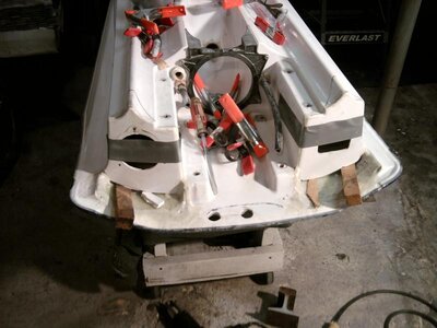

Thanks Jake. A few more - transom plates are epoxied on... gotta clean up for a wedding reception tonight. Tomorrow I'll be doing more.

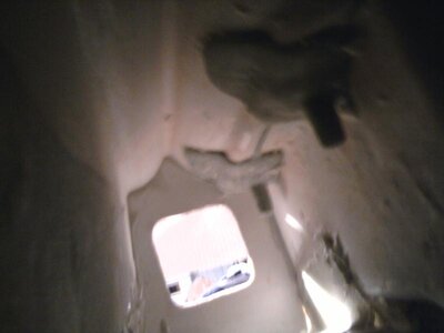

the last pic is an inside hull shot with the transom plates in place.

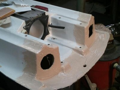

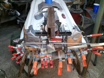

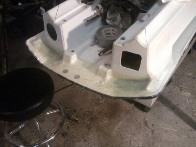

updated pics... transom plates are set... reinforced inside and out... ready to move on.

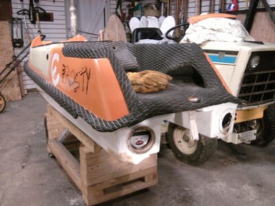

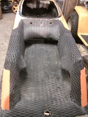

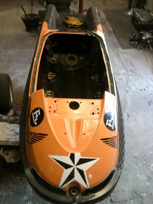

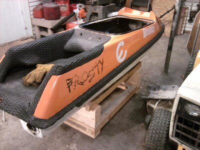

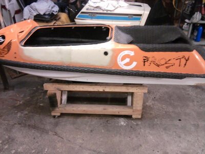

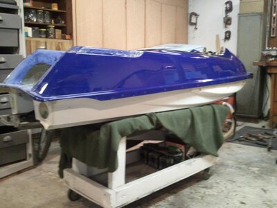

Couple hours in the shop today and stripped the old orange ski...

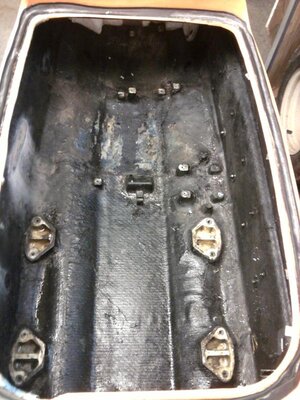

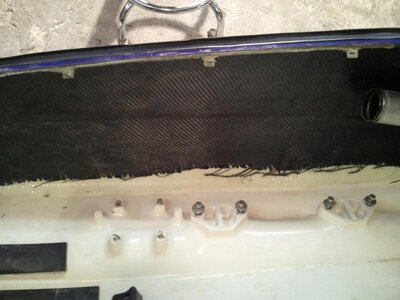

5.5oz carbon kevlar complete
started the tubbie destroyer install
pulled the mid shaft out of the mid housing - sending to Justin, along with my old motor mounts for the urethane upgrade
went through the ebox, majorly cleaned and installed a new gasket

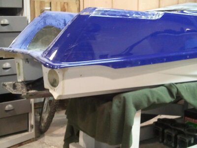

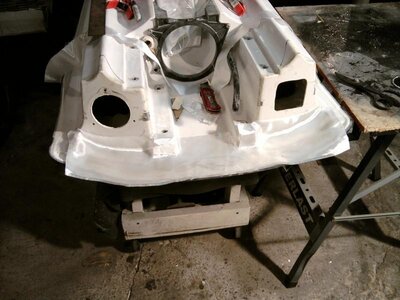

Added a layer of glass to the outside for strength, sanded and decided to use marine filler to make it smooth... After it sets up (about 3 hours) ill sand it smooth and seal it with a coat of epoxy... Then paint.
