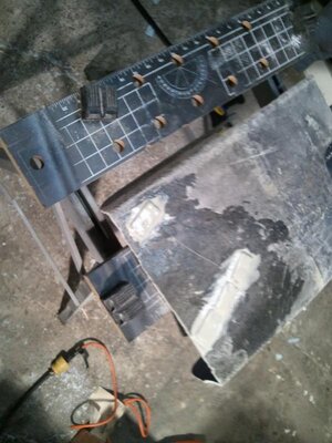

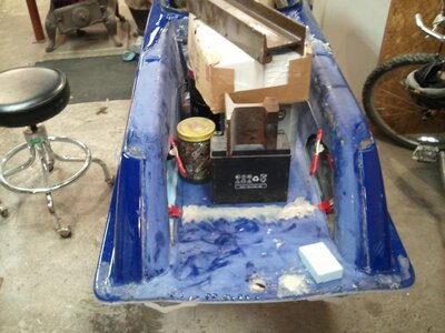

got the marine filler sanded and skim coated. I'll final sand tomorrow and epoxy seal it... then ready for paint.

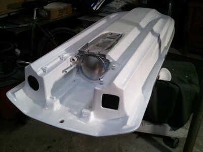

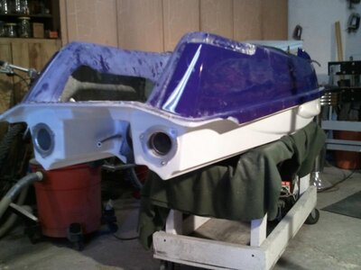

rattle can painted... until I see how it handles... in case I want to cut more off... then I'll have it custom painted.

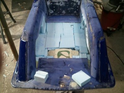

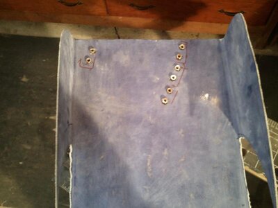

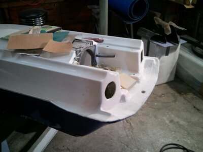

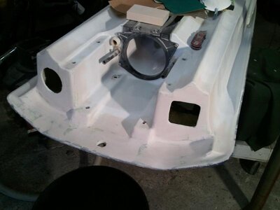

Going with a front strap, as well as a front Caker foothold... just so i can mix it up. I installed 4 SS plate with acorn nuts welded to them - epoxied them from under the tray so the acorn nuts stick through. Less obtrusive that way... and I know they won't pull out. I installed them so i have a variety of placement angles for surf stance, so I can find my sweet spot. Also poly foamed my tray area, and panel fused the tray in place... next step - glass the tray in... then install footholds.

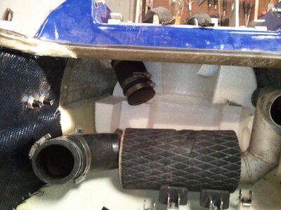

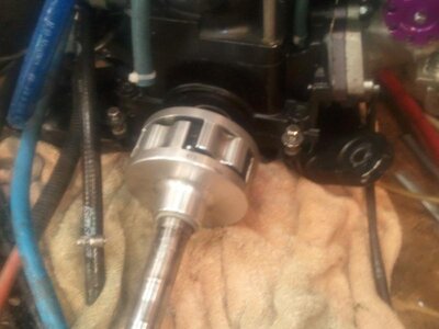

here's another one... went with an internal fuel filler on my old ski, but filled in the external gas cap area. Not this time. Kept the internal fuel filler, but used the oem fuel filler to make a storage compartment to keep my cash and stuff...
cheap and simple... furnco fitting attached to fuel filler... 2" PVC and plumbers end cap... cost about $6.
