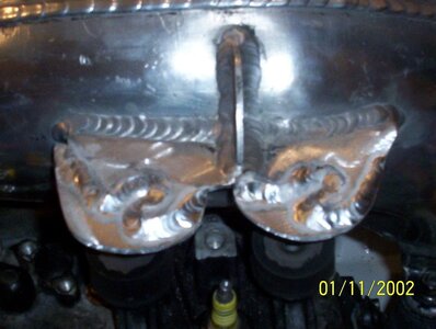

Cut my hood last night and installed my breather hoses. I just used the 2 stock hoses and cut them to fit, one sits above the gas tank and the other one angles down between the battery and flywheel cover/gas tank. I used 3m's 5200 to keep'em in
Also, the mounting brackets on my pipe were a little bit botched and cut/slotted and did not line up very well. I had my little brother tig weld some aluminum tabs onto the existing brackets and I drilled new holes in line with my rubber dampers.
The rubber dampers riva sent me are the only ones they offer for that pipe, so instead of complaining that they are 2 short, I grabbed some coupling nuts and drilled the threads out and they act as spacers. The rubber will still take the impact enough to do its job.
Only thing left is to install my pump but ive been waiting 1.5 months for a STUPID bracket for my trim thats on backorder from pro tec. It was at first a 2 week wait, now its 6? screw that, anodize the da mn things and send them out!
Then all I need to do is put those brackets on and get some new plugs and im ready to rock and roll!
