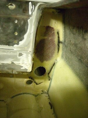

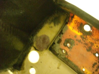

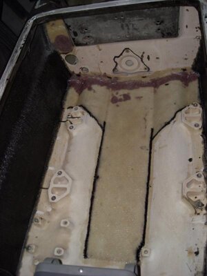

Old exhaust hole= Done. When i cut out the new hole, I kept what I cut out, stuck it in with some filler, and laid 17oz over it. Pulled the tape off the backside after that got tacky, and added a little filler and added a layer of 17 back there too.
Floor reinforcement in front of transom reinforcement = Done. Single layer of 17 biax.
Engine compartment is officially done except for some sanding in prep for paint in there. WOOT MOFO's
Tomorrow I start making the footholds/tray fit in while I wait on my one way to come in. Tehehe
Kennay
Squarenose for the _____
Myrtle Beach, SC
I forgot I also has to fill in some hole an owner in the past made while screwing a bilge pump into the bottom of the ski. Retard.
Today filler were 50/50 cabosil and microballoons
Aaaaaand with me being the pic whore that I am, here are said pics
Forgot to mention... everything done today was with scrap material, you couldn't tell could ya? haha

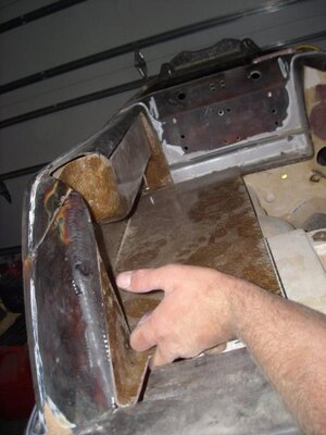

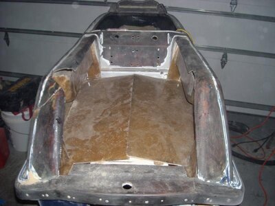

Well, I didn't really get much done today. It took longer than expected to cut these tricky ass footholds out. I am going to have to foam under them before I can get them trimmed perfectly, or as close to it as I can get... just way to big and awkward to try to keep it in place and mark and cut, ect... Last pic I wasn't finished, but I've since cut the ankle area out too on the right since the pic
I am going to buy some pink foam tomorrow so I can lay a floor in there to mock this up.
