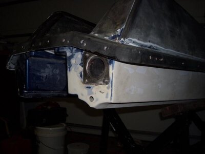

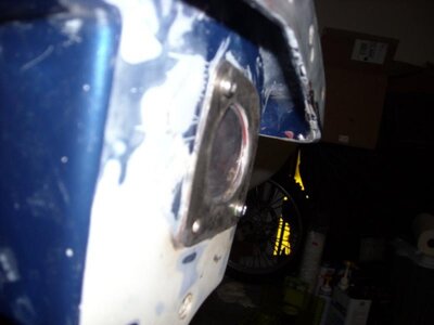

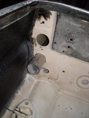

Well, no glassing, but I lowered the exhaust tube, and my friend the BFH, a brass punch, and myself made the flange flush with the transom again. Hooray for Fox liking butseckzzz!
