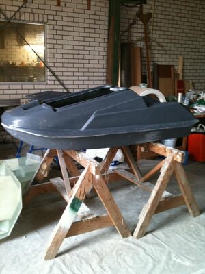

Custom/Hybrid my obsession back flip hull ??

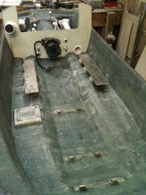

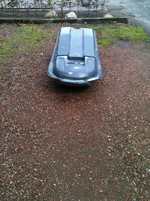

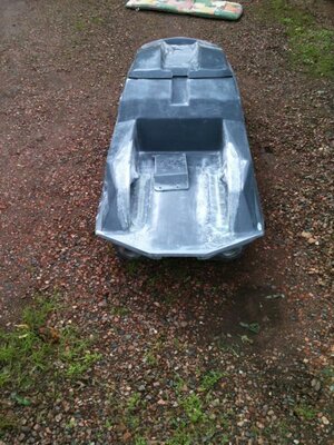

Is it an optical allusion, or is one chine much longer than the other? (pic#3 above, right chine looks longer than left)
the chine is exactly the same as the other side , it is because i did use gelgoat that is for sanding . when the ski is ready i go spray paint it .
so it is an optical allusion .

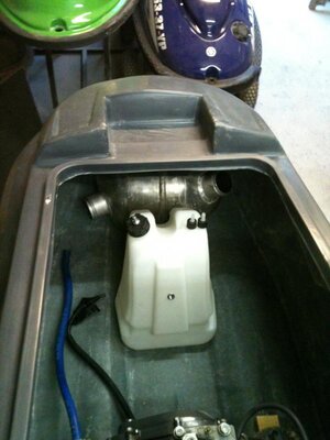

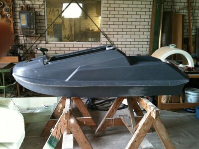

telefoon foto's 002.jpgtelefoon foto's 001 (2).jpgi have made a top deck ,and it came out nice .
now i only have to make a inside of the hood .
i will try to make it this weekend .
it is a lot of work to make my own ski ,but i keep learning al the time .
and for you who want to have numbers , the weight is 25 kg right now.
i hope when al is ready to make 35 kg .

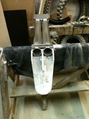

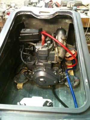

telefoon foto's 002.jpgtelefoon foto's 001.jpgi have decided to make some adjustable motormounts , so i can play with the motor position if needed .
the more i look at the ski , i think the next ski will have the topdeck a little lower than this one . i have some no needed space above the motor , what do you guys think ??

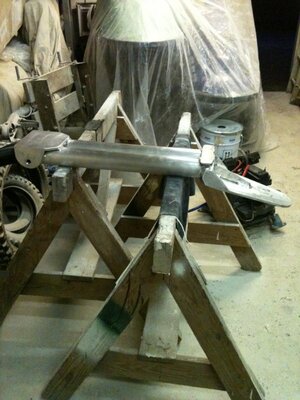

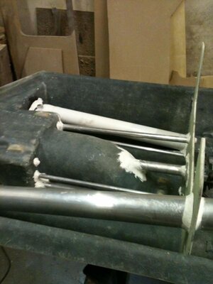

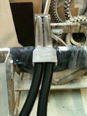

telefoon foto's 007.jpgtelefoon foto's 006.jpgtelefoon foto's 005.jpgtelefoon foto's 003.jpgtelefoon foto's 002.jpgtelefoon foto's 001.jpgeverything is built together , and now i did bring the ski to the painter ( i can not wait for the final result ,and how it will look like ) i also made a breather handle pole !! i hope it will work . i will post pics when it comes back with paint on it
