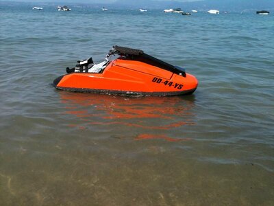

just got back from italie today and i have some ride reports !! this is how it sits in the water and i think it looks and levels good in the water ! there was some interest from the people there !! . as i have not riden a freestyle hull ever before , i was very impressed by how it performed , it feld very stable and it turned very short , it jumped out of the water every time i turned on the trottle . after spending some time on it (mayby 20 min or so ) i thought to give it a try and flipp it !! i did hit a small wave , pulled the pole and trottle and before i new it i was completely up side down in the water !! as i have never ever flipped a ski or something before and there is no trim on the ski at this moment , i am impressed at what the ski is capable of !! and with a good rider on it , i think it wil flipp easy . at this moment i am using a 61 x motor from a fx-1 with a faktory pipe on it and a 144 mm superjet pump with a 13/17 impeller they say ( i am not sure about this , because i bought the used pump complete with the impeller installed ) my plan was to built a ski witch not need a big HP motor to flipp it . so i have to start with a low HP motor and built from there . after countles attempts of making a 180 jump , the ski had a small crack in the handle pole area !! so this week i am gona make it a little stronger there , but okay this is my first built and this is still a prototype !!! LOL sorry now film at this moment , but in a few weeks a better rider will test ride it and then i try to make a film .

i have made trim on it and new video's will follow
