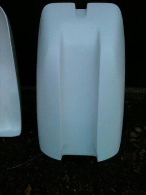

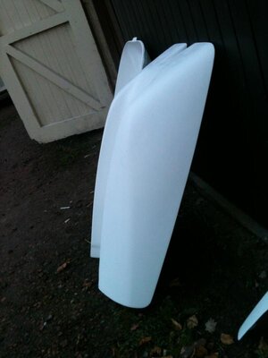

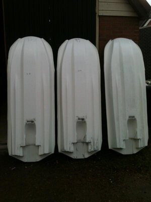

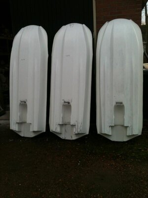

telefoon foto's 063.jpgtelefoon foto's 064.jpgtelefoon foto's 065.jpgtelefoon foto's 066.jpgtelefoon foto's 068.jpgtelefoon foto's 067.jpgproduktion of the new hull's has started !!lol

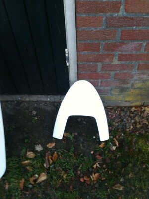

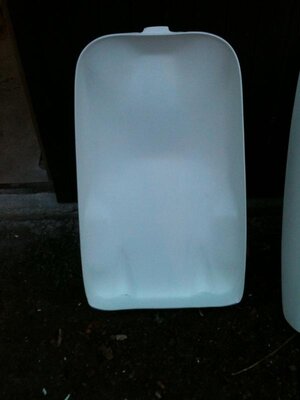

i also made a mold for a lowered hood for my superjet .
also busy with a drawing of a billet pole !!! keep you updated when i progress
thanks for watching my projekt
marcel
i name it OBSESSION !!the hole projekt is a obsession for me (says my wife)!! lol. but i did not start a bussines and producing them !!! i make a new one for myself and one for some testing and one for spare.
