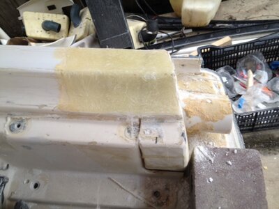

I'm fairly confident in where i'm at so far. I took a grinder to it today to taper the hull and where it will be glassed to for a better finish and reduced thickness, while maintaining optimum surface bonding. I hope to get some glass work in over the next week. fingers crossed.
not a huge update, just started some basic glass work last night. Will be doing some work on the rear section tonight. Hope to get it right side up by the weekend. but trying to take my time and do it right. No reason to rush things.

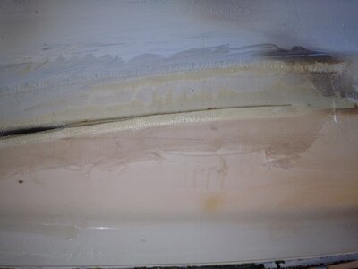

Just nickel and diming stuff at this point. I had to rebuild the rear end piece for the drain side, but i glassed the lower edge of the exhaust side last night.
I need to clean up the endges and glass the sides tonight, as well as clean up some of the glass i layed tuesday night.

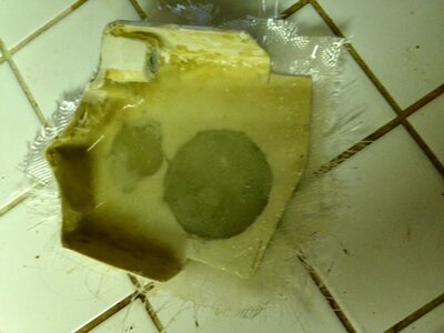

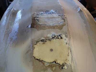

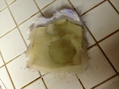

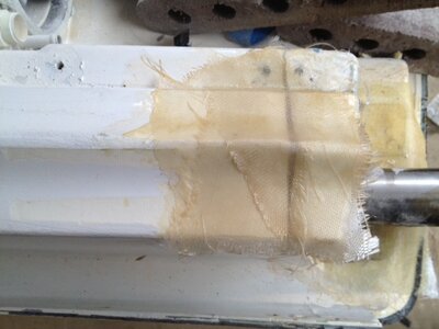

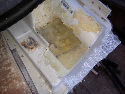

I pulled the rear of the drain side off as it has had a rough life and needed some rebuilding, took a grinder to it, and layed some glass down to build back up it's strength. Here's a few photos for you.
that side use to have a duck bill drain way back when, and have since gone to a versiplug max. but it was weak. Now it'll be solid.

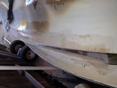

minor updates this weekend. I started glassing on the other rear section of the hull for the drain.

trimmed up the glass on the drain side of the hull, no additional glass tonight, going to rain and don't want to deal with it.

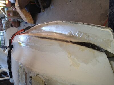

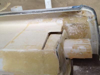

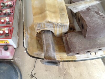

here's a couple pigs on where the rear sigs so far.
