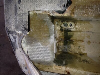

photo3.JPG drain side cut back, need to ensure solid seal and glass the tube in, as well as reinforce the cut back.
photo2.JPG exhaust side cut back, need to reinforce and finish up.

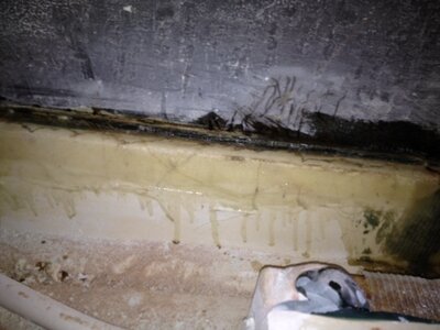

photo3.JPGreinforcing the crack along the side. love the drips! don't care much, i'll sand them off when i reinfoce the hull

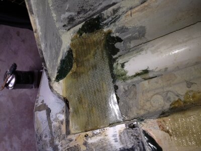

photo2.JPGyou can see some of the glass on the sides and bottom from reinforcing the cut back.

so i've removed the foam and since filled the ride side tray bondline with 5200 waiting for that to cure (7 days) I've got about as much glass as i wantt o put on the inside of the cut back for reinforcement purposes. will do a layer of 1708 biax. on the outside of the tray (bondline)
