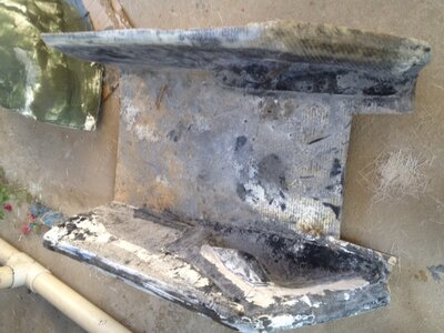

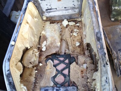

alright guys so it's been a little while. was wrapped up in some other things.
finally came to the conclusion that removing the tray and defoaming the ski would also allow me to have more security in my work as i can glass everything in from the inside of the ski.
a few pics of where i'm at so far.
most of it out yesterday, may get it all out today.
mix of fishing knife, razor blade scraper, and pry bar. working fairly good thus far. digging the foam out from around the scupper tube is the hardest part. limited work space.
