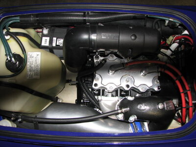

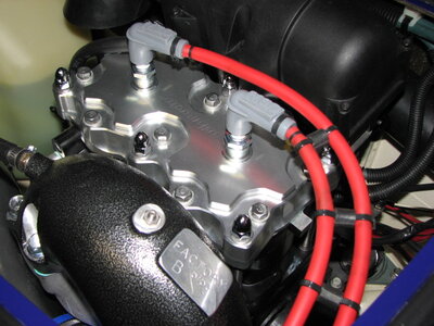

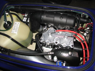

Last year I found some leaky crank seals and my compression was getting a little low so I am tearing the motor down and doing a few extra things.
Motor:
bore to 81.5
wiseco pistons
TW porting
replace front and rear crank bearings and seals
ADA girdle head with 35
port match bpipe manifold
MSD enhancer
replace falling apart k&n arrestors with new factory unit
carbon tech 202lt reeds
Hull and other stuff:
Light carbon reinforcing in engine bay (thanks to a sale at uscomposites)
replace pump bearing(s)
hooker impeller (have not decided on pitch yet)
clean up pipe so it doesn't look like some one puked on it
