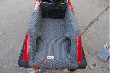

Why was the PVC left haning out the scupper?:dunno:
Didn't you seal it off prior to closing up the holds/deck?
