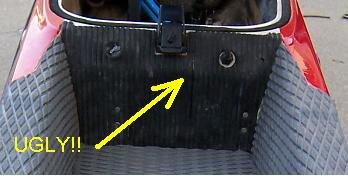

Matt, you don't realize I'm slowly working my way into Team Ugly while you've been working your way out.

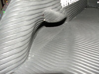

Looks good.
What did you do around the footholds?
that's not the 'normal' wammer cut on the top edge (like mine)...
One piece for the sides, and it wraps around into the foothold. I probably need to put some more inside the footholds, but want to ride it first to see if it needs it or not.

Like I said, I probably need more inside, but the places where my shoe will touch are covered, just not sure how tight until I ride it.

Do you find one piece is better versus a few pieces for the foothold?
Doug
It is a cleaner install........... plus, seams are weak points............. Just heat the turf up, and wrap, you may have to make some relief cuts when you turn under, depending on the foothold design, you may have to add a wedge (but it is out of site) or you may have to actually remove a wedge..........

I'm not sure if you can tell, but I also shaped the 25mm underpad slightly going into the footholds, it just barely slopes downward.
