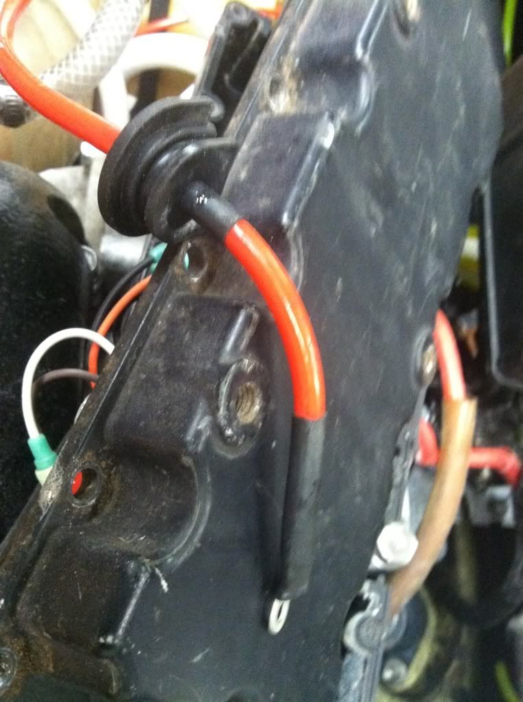

A buddy suggested that I add a extra ground, I used the over temp grommet to run the wire.
All of the ground connections, despite the surrounding corrosion, looked solid. There was shiny metal between all the connections.
