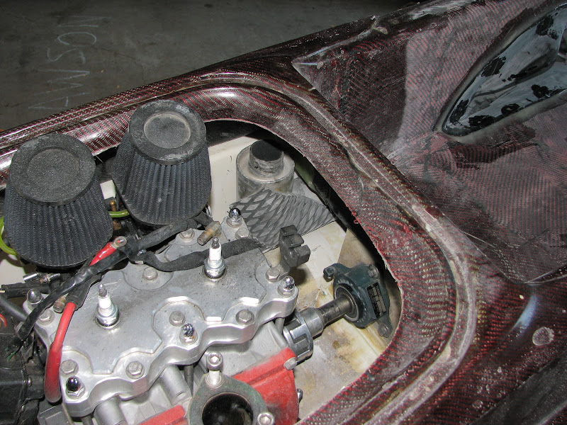

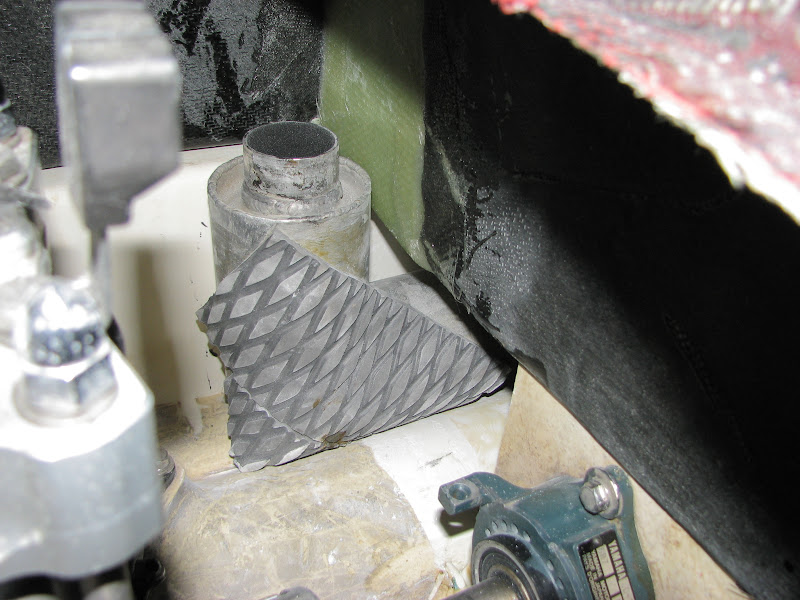

Some pics of the exhaust in place and how the bilge looks.

exhaust is glassed in and the rear sides of the hull are reinforced with 17oz biax. Just a couple more small things and I can bond the deck to the hull.
I also picked up 12 2" c-clamps from Harbor Freight today, $12.59 total including tax, gotta love a sale!

from what I see in the pics-slap some turf and a hood seal on there, super glue the deck to the hull and lets ride it!!! LOL
U r getting close now, keep up the good work!

The exhaust is done both inside/out and the top deck is almost ready to bond to the hull, hopefully this weekend.
