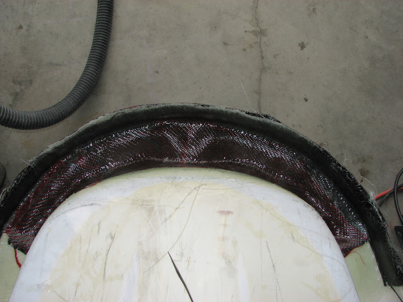

First 3 layers of twill are laid in the nose to give me something to work against tomorrow. Next up is the heavier stuff plus some carbon and carbon/kevlar.
SuperJETT
none
The lower lip is built and curing now. Lots of fiberglass twill, some carbon fiber on the outer part of the bondrail, and some carbon/kevlar with more fiberglass twill to wrap it all up.
Next I'll do the inside. This should be fairly bulletproof as beefy as I've built it---I'm sure I'll test it out quick since I seem to love hitting bottom.

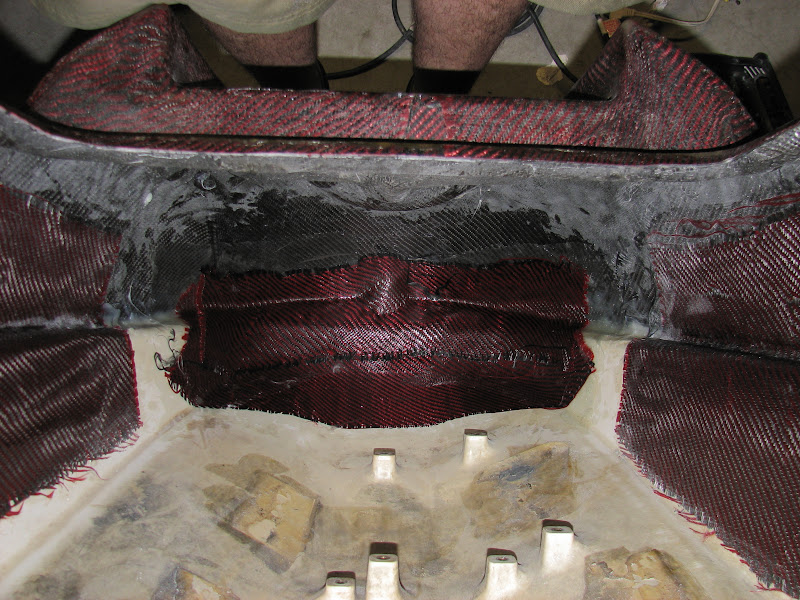

The inside of the nose is done, lots of twill and carbon/kevlar with thickened resin filling the bondline first.

Man on a mission!! Are you going to pour some foam in the nose and put another layer of cloth over it?
I was planning on it. I'm also considering making a foam insert that is removable, but that might take too much time after shaping/glassing it to make it waterproof. We'll see.
