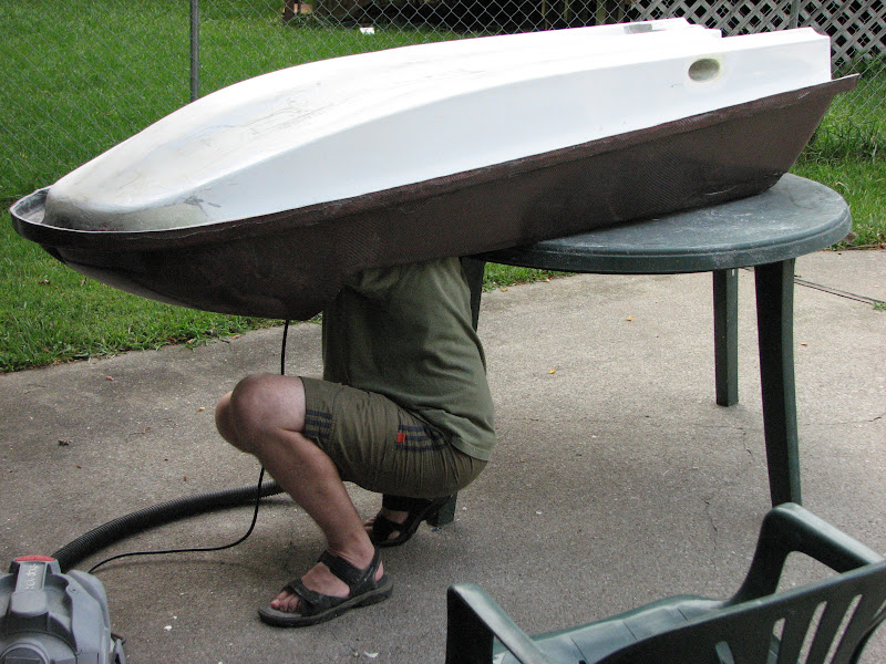

Here I am sanding the foam flat so I can lay the biax across the bottom of the handlepole area to the sides of the nose.
Sander, vacuum, and me all up in the nose.
It might have been easier if I had it sitting on a dryer instead of the old table...

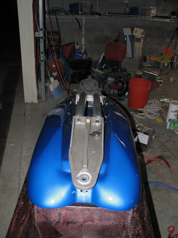

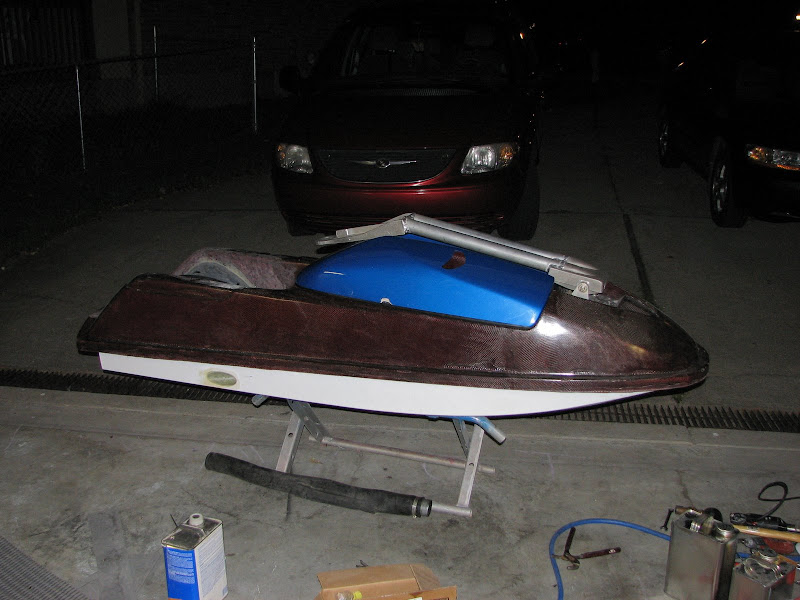

Handlepole, hood hooks, hood seal are all on. I also got all my exhaust pipe/etc ordered and should be here Thursday, scuppers by Friday, trim cable is on the way too though it's not required to ride.
I have to trim the Watercraft Factory nosepiece to clear the handlepole then it can go on.
The XR Tech handlepole is really nice, beefy too. And no, I didn't get a weight on it, but it feels like my shortened stocker. I may pull it off to get a weight before pulling cables in.
