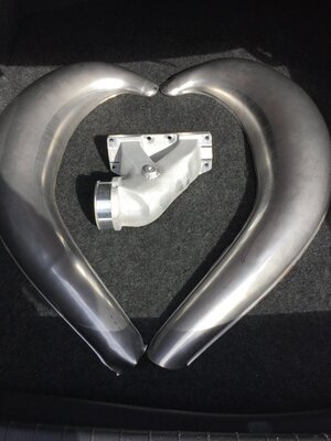

Awesome @tntsuperjet. Thanks for the answers. Please post pic of the V3 asap. Sure it looks top notch like your other work. Hope to get one in my boat end of this month

I have done testing with with both pipes on stock 701 and 760 and there very close.
The v3 might be slightly less tune work to get top performance

As for port timing. They don't like really tall port timing
There built to make tq.
188-196 exh. 126-128 intake.
They still work good on dasa that has 131 205. But you need to be big to get away with that.

Any pics of the pipe all welded together? I live the way the V2 looked but I got a feeling this v3 is going to look even sweeter!
