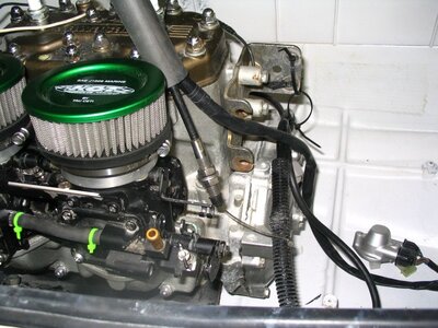

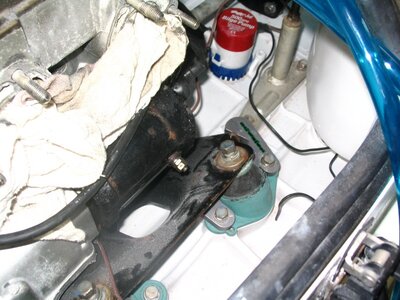

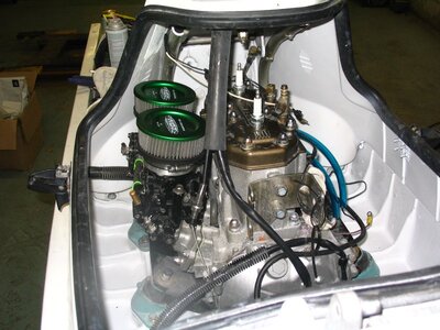

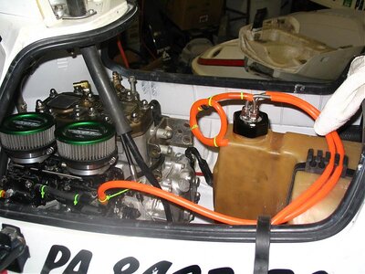

Started putting the motor in today. I cut the hos efor the new exhaust outlet and ran cooling lines. While mounting the motor I figured I would see if my Kenney Keepers would work and sure enough they do :arms: . I am having trouble with the throttle cable mounting. I cant find a bracket that will work and the cable is to short so I ordered one for a 98 sts. I need one that is 40-44 inches.

You should be able to work with the stock cable if you push it up the tube a little. Shorten the rubber tube so it lets you get the 45 degree angle you need to pull the throttle shaft like the Hot Products brackets have. Unfortunately I don't think they sell a bracket that will work with the I-body square diaphragm. If it was diamond like the regular body carbs you could use part number RY12-TCB Hot Products Carb Bracket,
http://www.hotproductsusa.com/PDFs/Hot_Products_2006_Catalog_Fuel_System.pdf
but it won't work for what you have. I think you could just make a bracket out of .09 aluminum pretty easy to get it working. I did for my SRE carbs.

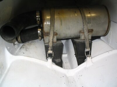

I also recommend the foam in the nose that the last X2's (95)came with to rest the waterbox on. You can carve it out to get the water box lower and get the exhaust tube to go straight out rather than the awkward bend. Plus it is way lighter than the rubber things and it floats.

Pete, I tried 55-3317 bracket, look at the way my carbs mount (pump out) it wont work. If I was running 44's it wouldnt be a problem. I will try and get the foam, thanks for the idea.

Yeah your carbs are kinda reversed but I think you could make your own bracket that would be similar that would mount above the diaphram or use the top two screws that hold the diaphram cover to mount. just a straight piece out that you twist a 45 angle into to get the right pull on the throttle shaft arm. I made one for my SRE 46's I just got and it was a 10 minute job with a band saw and a vice.

I thought about making a bracket off the head. I am going to the shop today to figure something out. If all else fails I have the new throtle cable comming wendsday.

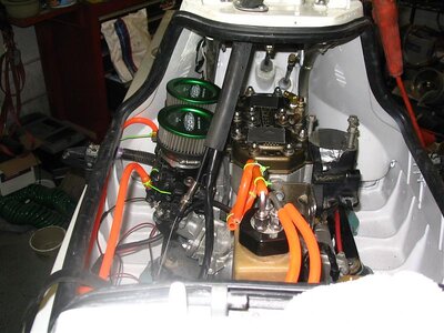

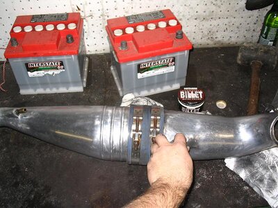

So as usuall I am waiting for parts so I decided to run my fuel lines and polish my exhaust (it is in ruff shape). All I need is my throtle cable, impeller and coil and I can fire this pig up. I will mount the pissers once I get the exhaust in.

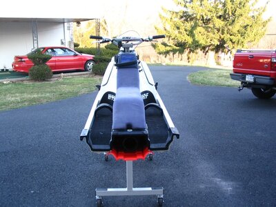

So this week I started my re-enforcement of the side's and my tubbie install. I also glassed in some aluminum plate for the foot straps. Im not happy with the way the Tubbies came out , Unfortunatly my supplier was out of fast cure adhesive so I cant do anything to them for a week.
Do you bolt your foot straps to the inside? I thought that they are supposed to be bolted to the bottom? What kind of straps are those?
I bolted them to the outside rail and screwed the inside in. I mounted the straps in a U shape. I used dakine windsurfing straps.

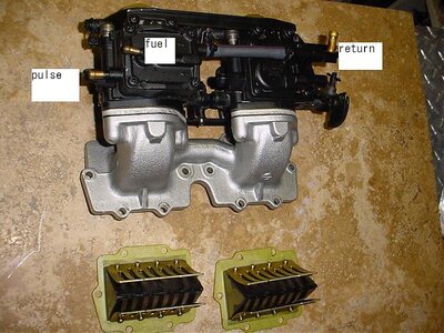

Slicker, is this correct for the fuel lines, or is the pulse and fuel inlet reversed?
