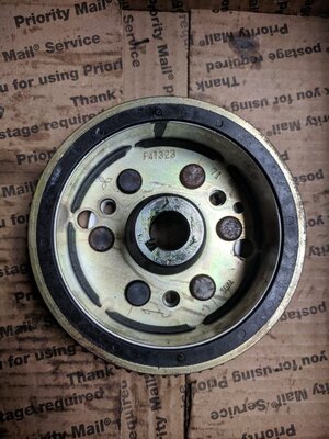

I have the Zeeltronic PDCIS-02T. I want to knock out my magnets and run as a loss ignition with my 64x flywheel. Do I still need to grind off the extra pickup bump? I have most of the wiring figured out but I might need a little help once I wire my box as well.
Yes, you still need to grind it off. Magnets are not related to the trigger.
If you want the most from your TL setup, you can send it to me to lighten in addition to removing magnets. There’s another 11 or so ounces I can take off, and remove the third lump.
