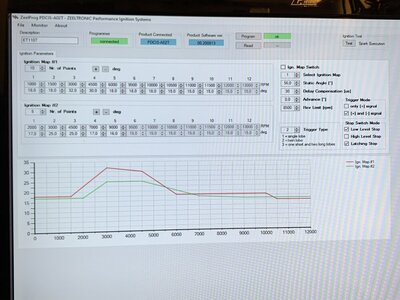

Soo installede my zeeltronic and hooked it up too the pc, does this look right ? It’s Yamaha ET 1107 set up.
That’s the wax curve. It’ll work but if you go back a few pages and find my old 1107 curve you’ll have better results. More advance earlier and carry it out to 6k then drop quickly. I can send you the file if you want.

Will your 1107 curve work good on my 967?
I’m guessing it would work well. You’ll honestly want to just ask art what curve he recommends. My curve is just a zeel version of what he recommended for the MSD. I THINK the curve I used would actually be less aggressive on a stock stroke motor because the piston is closer to TDC at 32 degrees on a stock stroke compared to a 10mm stroker but I’m no expert there.
Yes please if you Will sende the curve, i was thinking if static angal / delay compensation / trigger mode. Burut sende the zeeltronic made for the kawa 750 sxi soo not sure is that is info match the Yamaha ???
