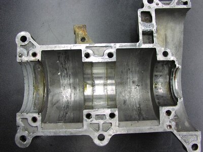

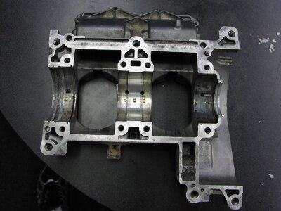

I hope the next build works for you. The odd thing about the case sealer buildup is that it was only on the bottom half of the case, not the top. It struck us as odd that one half would have been clean and not the other. The top half looked like hell, but there was no case sealant on it. This won't be a problem for the next build because we were able to clean the hardened case sealer (looked like Yamabond) off the surface.
As for anyone being anal about case surfaces, if they truly were, this case would be thrown away.

that crank ABSOLUTLY rocked in the cases.....when E DELIVERED it to SBT the first time he showed them and EVERYONE saw it rock (greg wasnt there at that time...)
the buildup of yamabond...was there from assembly #3 of the motor..
I still question the measurements......E's instrumentation (vernier micrometry) is THE most accurate way to measure....
ALL of our OE cranks dropped into these cases (as well as 2 other sets) like butta!!!!! however, the sbt crank would not fit into ANY of the cases without rocking....

like I said...EVERY OEM yami crank we had (I personally have 3) fit into the cases PERFECTLY....let me say that again...PERFECTLY..with no problems, no rocking, perfect sealing...even dirty ones that havent been cleaned since disassembly
its not the cases
