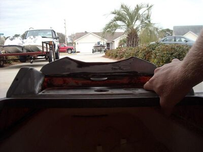

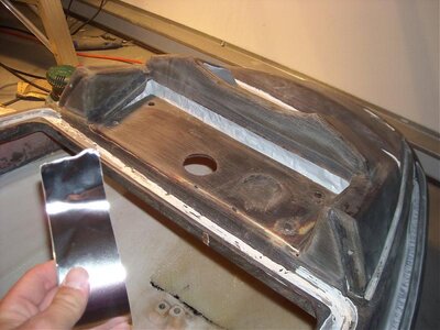

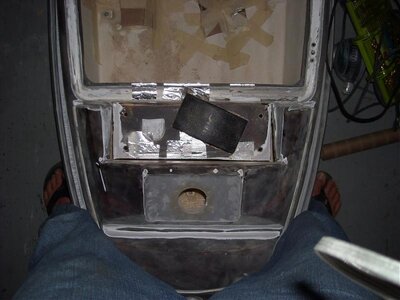

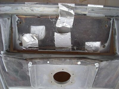

Well, I got the top area of the bracket done. I stuffed the gap with 1/2" chop, and layed down a layer of 12ox biax in one direction, and another layer in the other direction. Most of the strength and rigidity is going to come from the backside.
I rolled out a few more bubble after I took the pics, and now I am waiting for it to cure a little so I can go and trim it all up.
Here be teh pictar3s
