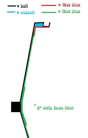

I am planning on doing the inside just like I did the tray area. I took cabosil and filled the bondline, and then a 6" strip of 12 over that, and then a top to bottom piece over that, all done in 12oz biax, with us composited medium cure epoxy resin.
The bracket area is still up in the air
As for the hoodlip area, I was planning on filling the void with cabosil while I have it up in the air, and doing something like a 2" strip of 12oz on top (Inside the ski, over the void, and down the inside). Sound ok? I would do this before I did the side reinforcement.
I will bust out the trusty paint skills.... :D

On the sides you can run a single piece of biaxle from the bottom all the way up to the top of the hood lip without any problems.
You'll have to make a small patch at the engine bulk head for the rear lip area and the front section should be one piece under the pole bracket incorporating the front hood lip.
I used the brown construction paper they sell at home depot to make the templates then used a magic maker to trace the inside contours out.
It helped to transfer the outline of the hull to the biaxle for a perfect fit.

It will work fine with one continuous piece of glass under the hood lip area.
It's almost impossible to sand epoxy with cabosil if you're going to fill under the hood lip, the micro balloons would work better in this area IMO.
Cabosil is more of a thickening agent, while the glass micro balloons are more for structural filling and light weight.

I've been laying it on while it's still wet/tacky. That bad? I haven't been needing to sand it because the glass has been smoothing it out where it lays overtop.
