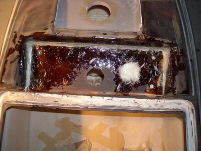

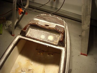

some more, I will post some more when I get it all trimmed up later tonight.

And it's not completely 90 degrees "Flat" but it was close enough to say ******** IT. :smoker:
When I put the tape on, I forgot I was going to need to bubble it out at the bottom, so when I bubbled it out, it lifted the flap of fiberglass slightly. Tis all good though. Running a unmodified roundnose pole and roundnose bracket with a limiting strap should be no problem at all. :)

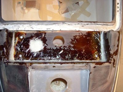

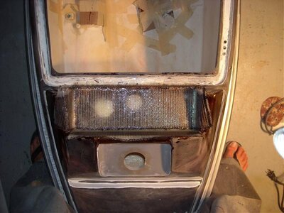

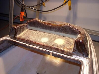

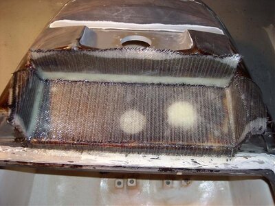

Last couple pics until the bracket area is done... I promise :D
I almost messed around on the pc too long and didn't trim it up in time! I had to cut it and the grab it with pliers to pull it off. I almost had alot of grinding to do.

I couldn't work on this stuff lastnight, but I am planning on grinding everything back on the underside, and laying the glass for it tonight.

Well, the bracket area is curing on the underside...... I ended up using 2 layers of 12oz, and 2 layers of 17oz. I did a left to right 12, and then a front to back 12, then a left to right 17 and a front to back 17. I used the 12 first to make sure the sharp corners wouldn't come up, so it would sort of build a softer edge for the 17.
Monday afternoon will be foaming all around the bracket area and glassing that in. :) Thanks again Rick!
