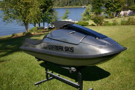

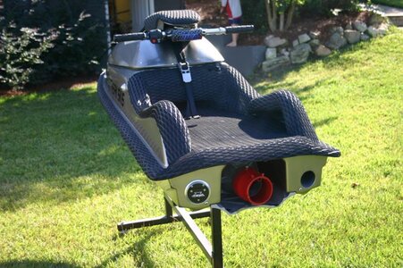

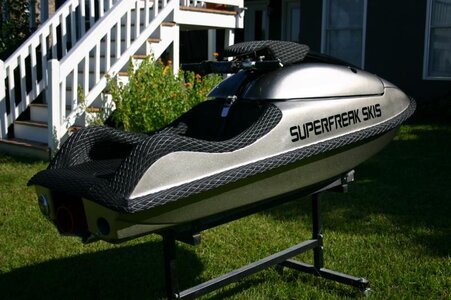

Thought I'd post some finished pics. Need to get some closeups of everything but was short on time with a cookout looming at 5:30 (it was 4:00 when I finished the ski!). I failed to take some pice along the way with the turf, bilge, ebox, pump and engine install. Turfing those Kawi style gunwhales takes some practice. They're a bit trickier than SJ's. I had a few "fubar's" with my turf job. Thankfully most of them are hidden or hardly noticeable.
The mid hull bilge was working fine in conjunction with the scupper. I really need to block off the trim tube until I get that situation resolved. I have some issues with getting my CATS trim to work, but that's all just getting the right hardware to make it work properly. I went back to my old redux nozzle/steering nozzle until then. DO YOU GUYS BLOCK OFF THE SIPHON PORT? HOW ABOUT ANOTHER COOLING PORT AS WELL? I've got my pump tapped for dual cooling and with the extra port on the redux nozzle open I was wondering if it was making a difference having the additional volume exiting the side of the nozzle (in addition to the siphon port open as well). I took it out for about 15 minutes after finishing today and was real happy with my setup. Looking to get a full day's riding in tomorrow. Water temp was fine. I was prepared to be shocked since it has been unseasonably cold here the last week. Hopefully my boys Waternut and Mcdog will be available for some riding time. It's been nearly 8 weeks since my last ride. I'm ready.

That turf looks great to me, it's way too easy to be critcal of turf but only you will ever see the flaws; to everybody else it will just be turf they didn't have to lay, which will always be awesome!!! :bigok:

Got a decent bit of riding time in yesterday. I'm real stoked with how the 'Freak rides and handles. It was super easy to jump from my RN to this hull. It has all the benefits of the RN handling with more stability, quicker handling, and I can get the rear end loose (predictably) for whipping around on setups. Going slow was no problem and I was able to get up to speed and chase a few boat wakes. I used to have a helluva time getting my RN to get loose and get it to hook back up for setups. It was real unpredictable doing this. I was riding without a limiting rope so it was treacherous trying to enter the water nose first so reports on that will have to wait. I was able to get the nose up and down easily. My 760 flat top seems to be plenty of engine for this hull. I was constantly wanting more power with the RN. Gonna sell some parts and save pennies for a mag pump next spring. Sucks to be getting colder. Waternut and Mcdog got some "saddle time" in as well. They can provide some unbiased feedback.
