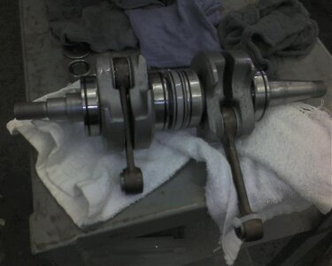

Got my crank back this week so it was time to work on the engine.
Pic 1
I got my crank back from ADR fully rebuilt for $100 :bananalama:

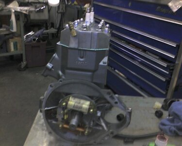

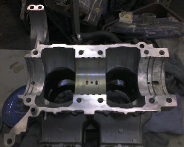

My crank case had to open a little to match the 1.5 over bore
Pic 3

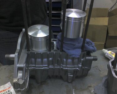

Crank all sealed up in the case, putting the new Wiseco pistons on
Pic 4

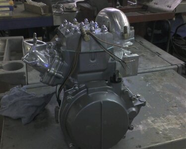

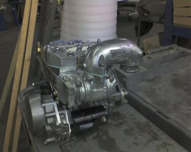

My mikuni Manifold and 44 blackjack cleaned up and ready to rock.
Pic 5
coming together Ocean Pro head back on, new stator advanced 20 deg I believe.

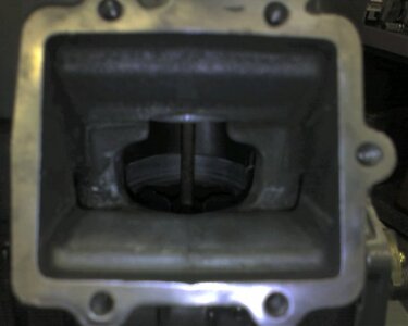

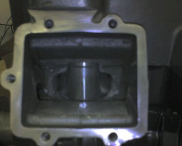

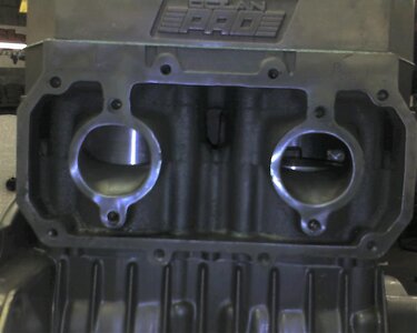

Right reed port of my Ported Cylinder
Pic 2
The left reed port

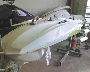

Update 2/27/08
Pic 1

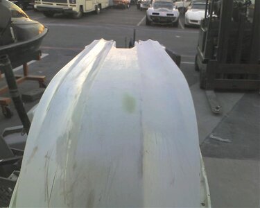

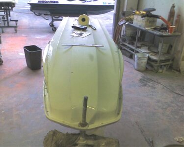

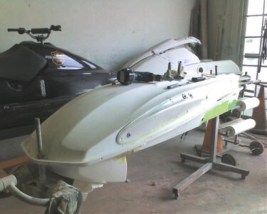

I'm going to Gel Coat the bottom of the hull white, thus i need to sand off all the old paint.
So with the rotisserie we got the ski upside down so i could start tube sanding the contours of the bottom to keep the shape and remove paint. (which takes a while and SUCKS)
Pic 2
The bottom before
Pic 3
the bottom after near the end of the day. I'm about 85 percent done with the tube sanding, I should finish tomorrow.

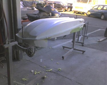

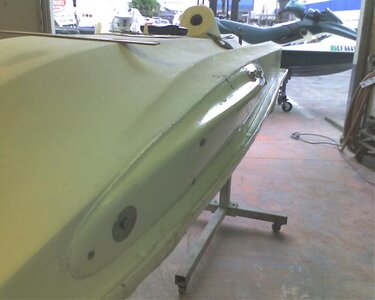

Update Tubbies and Paint! 1/4
Pic 1

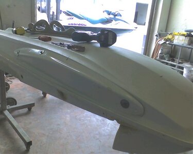

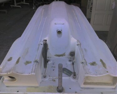

Trued my hull by tube sanding all contours and blocked the belly of the ski to perfect the hull.
Pic 2-5
Foamed both Tubbies, measured and aligned tubbies to bolt and rivet into place with a mass of silicone on the backside of the tubbies. It was really hard, we really had to crank on the outside bolts to bend the tubbies flush against the contour of the hull.
