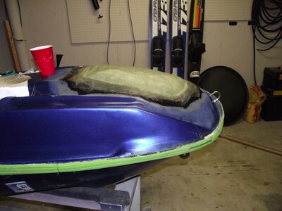

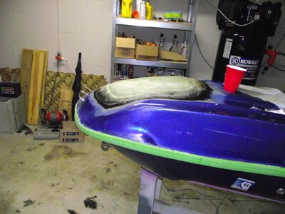

Lots of sanding later and some glass, this is the basic form. Obviously, there will be lots more fiberglass and the shape will be more refined but this is the first step... Not bad for a little over an hours worth of work tonight. I got motivated...lol
Shane, I will need some resin if you've got enough to loan me until I can get some shipped to me.

It's a free form. Glued the edges so the glass was a little higher than I wanted and let the weight of the resin and gravity do the rest. I did have to pull one edge up and tighten it up a little but can't really beat the simplicity.

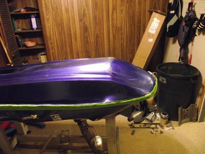

I didn't think much of the outside chines until I started taking pictures of the new profile. That center section was so drastic, it made the sides look fairly benign. If I do anything with the outside, I plan to finish the center first.

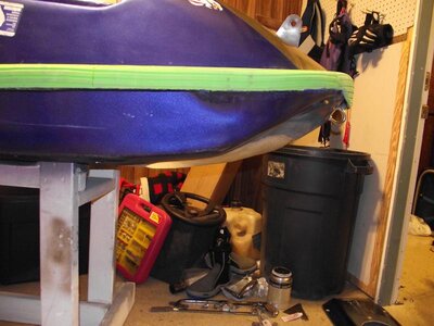

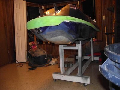

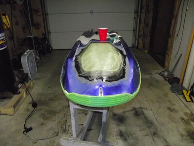

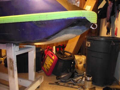

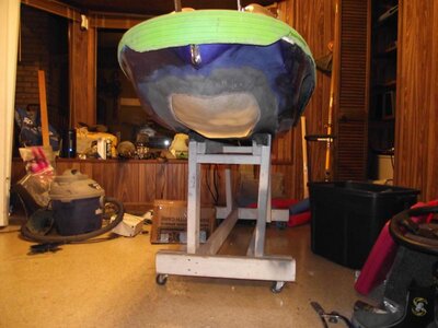

How about a before and after pic of the profile for a quick comparison.
If you know of a way to make one picture semi-transparent, I can lay one on top of the other. If not, this will have to do. I laid a few layers of 9oz weave tonight. Tomorrow, I will try to put a bunch of filler on there and get the shape perfect before laying a couple more layers of glass.
I also laid an extra layer all the way around the edge as a sacrificial layer because I know a good portion of the top layer, around the edge, will get knocked out when I start sanding and leveling.

Damn, there is no curvature at all to the front of the hull. It's rather abrupt.
You don't really see that until you see the two pics up beside each other.But looks dramatically different.Should be interesting how she rides out.
