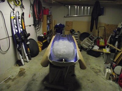

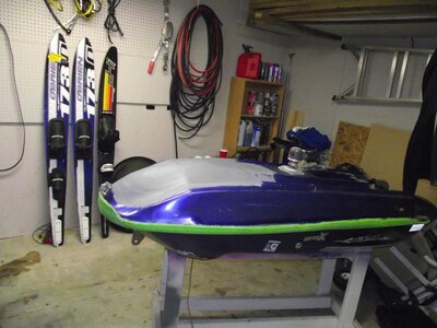

Yeah, now that you see the difference, you can see why I decided to cut a huge hole in a "perfectly good hull". I'm thinking this is going to affect how the hull handles in a tight turn when I want to get back to my setup wake. I should be able to figure it out regardless but we'll see...

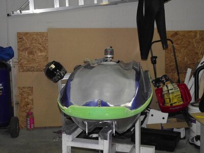

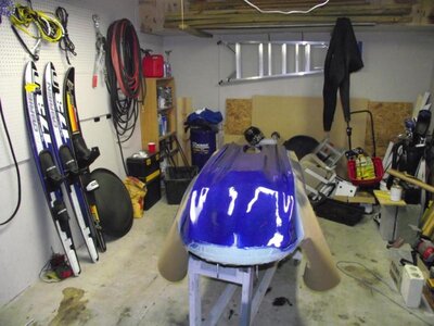

So far I've got a layer of 12oz biax on the inside. On the outside, I have 3 layers of 9oz weave, some filler, and 2 more layers of 9oz weave. Each one overlaps the last. I may throw a layer of weave inside the engine bay to make it smoother but I'm thinking I've got enough meat in there to hold up. Opinions? More? This is just a half arsed brush job of primer because I didn't want to clean the paint gun twice. I'll get to sanding a little later.

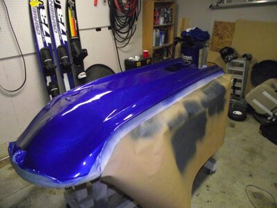

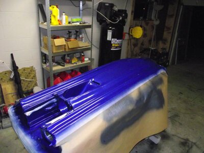

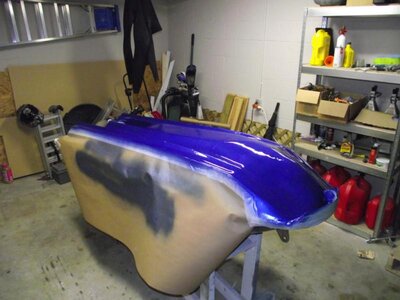

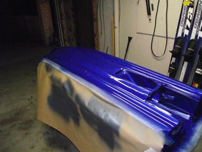

All done for this mod. I'm not going to bother with the slight corners on the outside chines.
I ran out of the blue paint that I originally used on this ski. This blue is what I used on my boat instead. I think it's a little lighter but I'll see fairly soon how close it is when I pull the masking off.

Nice work and probably a fruitful effort!
I bet this will be a major handling improvement. It would also be cool to see what the effect of softening the outside edges of the hull would be.

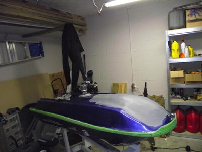

Well I finally finished this up. I put a stock RN waterbox in it and rebuilt the engine. Now the tuning is all screwy and it won't idle for more than a few seconds without giving it gas. The only other thing that I can think of that may have made a change was the carb position. I had to flip them around due to the throttle cable position on the protec intake manifold vs the 760 manifold but I flipped the pulse line as well. The pulse did have to be a little longer due to the funky positioning. The reeds are the same though. I added the stock fuel selector switch back in so that I have a reserve line but it blubbers on both lines. It hits good right off the bottom but when I try to jump, it doesn't want to rev out. One other thing... I primed the primer last night but all the primer lines were empty this morning and I couldn't get fuel back in them. Maybe it was causing issues but it was only on the "ON" fuel line and not the reserve line. Any ideas?
Anyway...ride report. Slow speed handling is similar to what it was at least on smooth water. Might be better in the chop. When I make a sharp turn, it seems like the nose dips down a little more and I slide some but I can recover. I think I'm just a little out of practice. Higher speed handling improved massively. I'm still breaking in the engine so I didn't go hog wild but I did get the ski up to what feels like 35-40mph (faster than I've ever gone on that hull without getting pitched) and it felt clean without any walking or digging.
