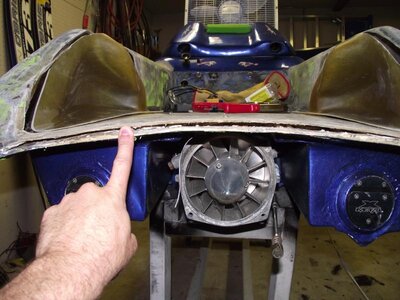

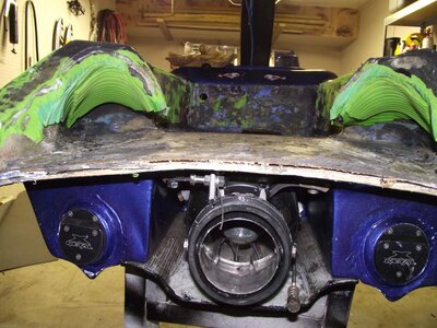

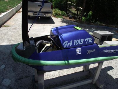

Reinstalled trim on my ski Thursday and broke it on Saturday....sweet huh? Well I used that as an excuse to pull the ski out of the water and tear into it. Apparently the leaky scupper was only half of the problem. Check out the gap between the top and bottom decks. First pic is just with the turf removed and the second is after I cleaned out some of the 5200. All of the rivets (20+) were either pulled loose or broken. Apparently, I've been really hard on this thing. I'm debating whether to just squeeze the top deck back down or just cut it out and glass in a new one that fits better. I'm leaning towards ripping it out.

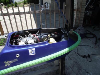

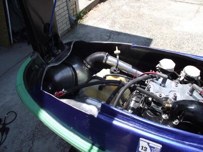

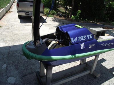

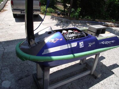

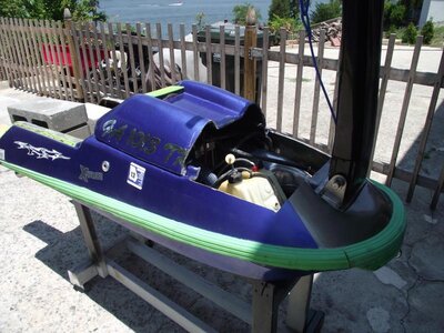

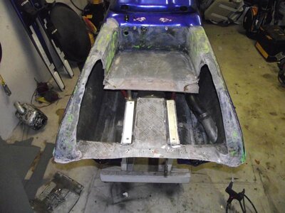

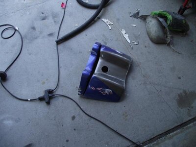

I decided to go ahead and take half the floor off so that I could make it flat. It has a slight curve to it normally and my feet slide out on a big jump.
Also, I've been thinking about making the hood bigger for a long time and figured now is a good time... Go big or go home right?!
